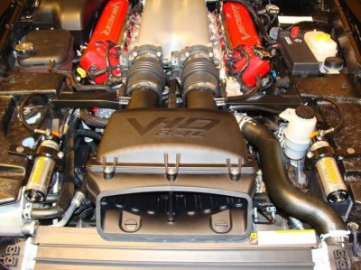

I understand about air in the lines vs. the nitrogen that they were originally serviced with. I bought the power tank set up from Nader so I have lots of nitrogen.... Here is the pic of a gen4 setup. Note where the hoses go.
Explain to me though what was done in the gen 4 install pics on the forum here how the hoses were run.

The hoses are run up under the inner fender liners and through the opening by the engine bay brace. I rounded out the opening in the carbon so the hose is protected.
It is not that there is air in the canister but when the hose is disconnected the oil escapes a little and when you re install it there is a little air pocket in the oil line and shock. This is what will affect the shocks performance because the air compresses and the oil would not.
