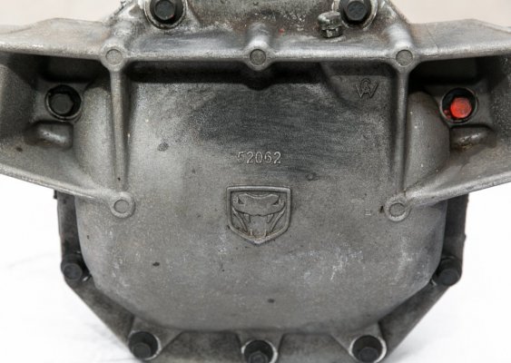

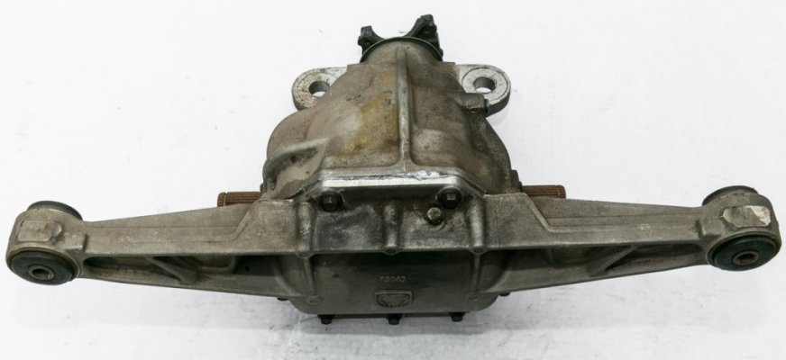

I'm looking to increase the gear ratio on my Gen 3 (2003) from the stock 3.07 to 3.55.
While I'm at it, I figured I should also upgrade the LSDiff from the HydraLoc (std on Gen 3) to the beefier GKN Visco Lok (std on Gen 4) which I understand is a significant upgrade in performance & durability.
Did anyone out there do this?
Are there any other changes to the guts that I need to make to make sure it fits my Gen 3?
Lastly, can anyone recommend a shop that can do this work?
I figure my local mechanic can remove the unit and ship it out to have the work done.
If anyone out there has one already built that they're looking to sell, I'd consider that too.
Look fwd to your responses.
Thx

I just did a straight gen 3 to gen 4 swap back in the day. The whole housing and everything is a direct replacement. But as Dan said, if you're wanting to swap gears while you're at it there are better options out there. I've heard nothing but good things about the Wavetrac over the years. I think the gen 5 unit uses different half shaft connections if I'm not mistaken (bolt on flanges instead of splined shafts), though it might be simple to convert, I'm not sure. You could always just put gen 5 half shafts on it as well I suppose if you went that route.

Yes, you are correct. You would need to either bring the G5 shafts along for the ride as well, or R&R the flanges and put G4 stubs in the unit for use on G3 shafts.
IMO... use the G5 shafts and upgrade the whole thing at once.
