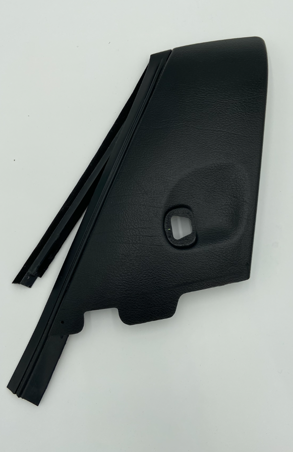

Does anyone know where I can find driver and passenger door window rubber replacements so the gaps will be filled? Seal it up.

can you be a little bit more specific? GTS/RT10? Are you talking about the vertical portion or the horizontal portion of the door? Pictures would be a big help too..

Sorry,it would be 98 RT10 with hard top convertible. So when you roll the window up the corners of the window do not seal as if there is a piece of rubber missing.

It looks like your stanchion rubber is slid down and shot. Supposedly Temple Performance was going to make new stanchions for Gen 2 RT/10’s but I don’t know that they ever did. I know they made new ones for GTS’s though.

Found them. Temple Performance did make some.

I’m really close with Jason. They only have Gen 1 stanchions right now and you’re correct, they are extremely durable and the best choice on the market right now. Unfortunately they won’t work on this Gen 2.
