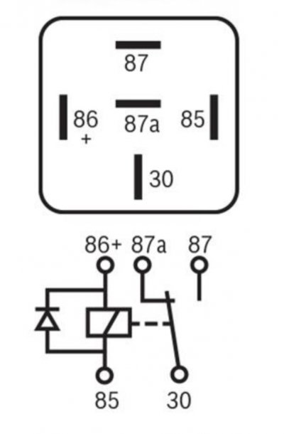

Crank engine. Listen for fuel pump run-on for a second after engine stops rotating. If you are getting FP activation, unlikely to be crank sensor issue, more likely Cam sensor. Otherwise, no FP activation when cranking often = bad crank position sensor.

I put my hand on the fuel pump relay and could feel it kick on and prime for 2 seconds when the key was turned to Run. Cranked the engine over for about 5 seconds and felt the fuel pump relay turn on for maybe ½ a second. Cranked the engine a second time and did not feel the fuel pump relay turn on at all. I have a new crankshaft position sensor on the way and will update once I get it switched out.
